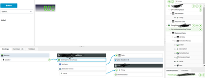

I have a main mashup which has some widgets. I added a button in main mashup which is for popup mashup. when I click on that button, a popup mashup is  getting populates. In popup mashup I have a dropdown widgets which I bind with the Things service like GetImplementingThings.
So now I want to know how  can we get back to main mashup from popup mashup after selection of thing from dropdown?

Hi @Pratik_Aswale
In Popup Mashup, create a mashup parameter to pass data from Popup to Main mashup. And bind dropdown selected text value to mashup parameter
In Main Mashup, map the popup mashup parameter to change the gauge value. In my case, I have mapped it to the Label

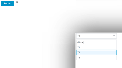

Output :

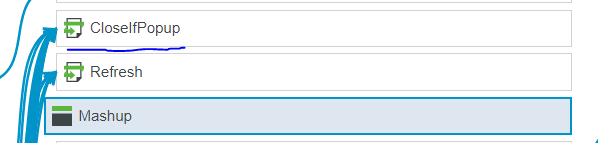

Hi @Pratik_Aswale
You can use "CloseIfPopup" trigger to close the popup when dropdown selection changed

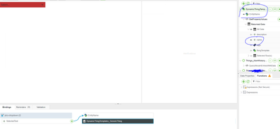

Hi @Pratik_Aswale
In the popup, you can get the Thing Property value and return the temp value to Main Mashup
or
In the Main mashup, use the thing name from the dropdown to get Thing Property values and bind it to the LED widget.
If things have the same thing template you can dynamically call ThingTemplate and pass Thing Name from dropdown to fetch property value.

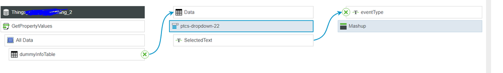

@Velkumar As you said I did in my main mashup same as you. but my usecase is for sending property data from popup to main mashup after selection of dropdown thing .
Hi @Pratik_Aswale
You can do the same thing in Popup. Instead of passing Dropdown value you can pass temp property value.
/VR
