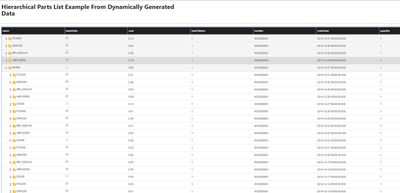

Hi @achitters you can use Grid Advanced Widget from ThingWorx Marketplace. It contains both Grid&Tree widget allowing you to display such a hierarchy. Additionally there's a sample entity within the zip that you'll download named GridAdvancedExampleEntities-v3.0.xml this will create some demo mashups and things with services to return demo data something the attached screenshot
