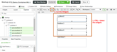

Hi developers,
I have a PTC Textfield widget binded to a datasource which usually has a big name but i have limited space on mashup.
I need to make it multiline but its not giving an option in properties.
On clicking wrap, its still not taking data in next row. Please suggest.
Hi @VK_10159720 ,
Kindly take this mashup entity backup before updating the below given suggestions.

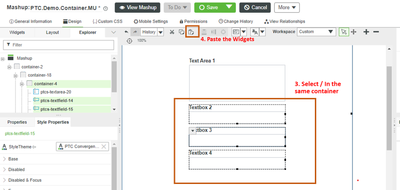

Using Cut & Paste option in  Design Time, we can able to arrange the order of widgets. After the Textarea widget in placed in last then Cut the another 3 textboxes by CTRL + Select the required widgets.
Without saving the mashup immediately please Paste the widgets in the same/required container.
Also you can select the each widgets to Drag & Drop it to the required place in same container.

Hi @Arun_C ,
thanks for your response.
Yes, i am aware of Text Area. Issue is that in the mashup which i am using, it is a responsive mashup and in one container it has already four other textfield.
The Textfield which is causing issue is the first one in container, if i try to remove and add new TextArea then that TextArea comes in the last of container and not in the first.
Please suggest
Hi @VK_10159720 ,
Thanks & Regards,
Arun C
Thanks @Arun_C. This helped.
