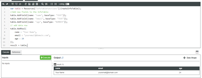

I hope this attached highlighted post reply link will helps ContentLoaderFunctions PostMultipart . You can define your own info schema or by using AddField and AddRow functions & then you can declare it with partsToSend Parameter in PostMultipart snippet.
