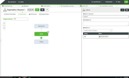

I want to give home mashup to every created thingworx user in particular group.
Currently i created user and added to studio-admin group by using service Now i want to give home mashup for every user or direct group for login?
I tried visibility permission service to group but confused don't know what to do.
I have added super admin user in super admin group, admin user in studio-admin group and trainer in trainer group.
how can i give home mashup to every user or group while creating user on mashup?
Please suggest
Here is my organisation.
