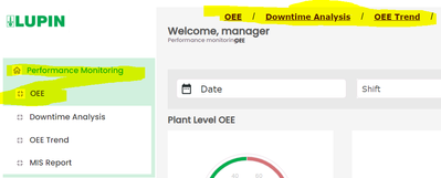

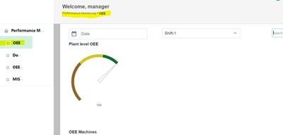

Hi @PaiChung ,
i am using here breadcrumb widget but whenever i select on one menu it shows all the submenu names in breadcrumb.
i am attaching snapshot of it please check and let me know how i resolve it

I haven't used the breadcrumb widget myself so I'm not sure exactly how that one works and is supposed to work together with the menu, sorry.

Hi @Ru.
It sounds like the breadcrumb widget is working exactly as it was designed, so if you don't want to see all the selections, you may want to remove that.
