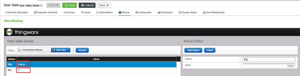

hello,everyone!
I want to change the data in the table automatically through the service.Please tell me what to do.企业微信截图_17092786501957.png

Hi @Snoopy_hu
Please find below code to update dataTable value through service or subscription
// CreateInfoTableFromDataShape(infoTableName:STRING("InfoTable"), dataShapeName:STRING):INFOTABLE(DATASHAPENAME)
let data = Resources["InfoTableFunctions"].CreateInfoTableFromDataShape({
    infoTableName: "InfoTable",
    dataShapeName: "DATASHAPENAME"
let newObject = new Object();
newObject.bName = "test1"; // MAP YOUR INPUT FROM SERVICE OR SUBSCRIPTION
newObject.bDate = 25; // MAP YOUR INPUT FROM SERVICE OR SUBSCRIPTION
data.AddRow(newObject);
// id: STRING
let id = Things["DATATABLENAME"].AddOrUpdateDataTableEntry({
	sourceType: undefined /* STRING */,
	values: data /* INFOTABLE */,
	location: undefined /* LOCATION */,
	source: undefined /* STRING */,
	tags: undefined /* TAGS */
/VR

Hi @Velkumar
I tried it and it did work, but how can I get to the point of automatically changing the value through services and subscriptions?

Hi @Velkumar
I tried it with your code and it worked, thank you so much!
