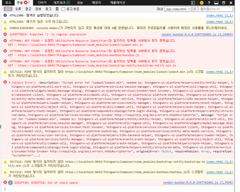

I installed ThingWorx 8.4 and opened the web with IE Edge and it doesn't open. I checked the message with the developer tools and the output was:windows ie 에러.png

I‘ve already reproduced your issue in Microsoft Edge 42/44 version in Chinese/Korean system locale, but works fine in English Locale.
This issue was reported to R&D as JIRA TW-50057, and had already been fixed in ThingWorx 8.5.
Here are the solutions for you:
1. Still use Thingworx 8.4 with IE 11/Edge, please change system locale to English (Control Panel>Region>Administrative>Change system locale) and restart workstation.
2. Use Chrome instead for Thingworx 8.4
3. Upgrade to Thingworx 8.5

The screenshot shows an "out of stack space" error.  As stated by @yanchen, you need to check the ..ThingworxStorage\logs\ApplicationLog.log to validate that ThingWorx is actually running.  If not, did you validate the system requirements before starting the installation?  Which installer did you use or was it a manual install?
