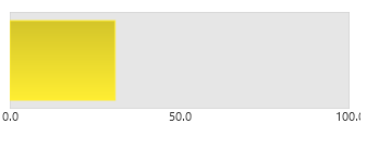

Dear Ptc Community,
i would need help to get a rounded  corners for my label chart. At the moment it looks like this and with edged corners it would be a lot more satisfying.

Add a classname to the widget in the 'customClass' field, for instance 'roundedChart'
Then put this css in the Custom CSS:
div.roundedChart rect {
rx: 15px;
ry: 15px;
