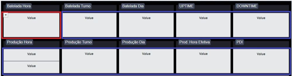

I have thinked it too, but what happens is the follow:
In my image below when I change the style theme of one value display (for example: red) the all others (blue) change too
I would like to provide definitions for each one

The Style theme is indeed applied at Mashup level, so if you change it on one widget, it does change on all others.
However you can customize specific widget by editing their Style Properties .
Do not touch the Style Theme , but change the properties, for example for the border of a value display: Base > ptcsvaluedisplay > Border.
This will then apply only to that specific widget, so you can set each value dialysis the way you want.

Style Properties don't work if value display is bind with some service (for example: getproperties).
To change it just creating a new Style Theme.
