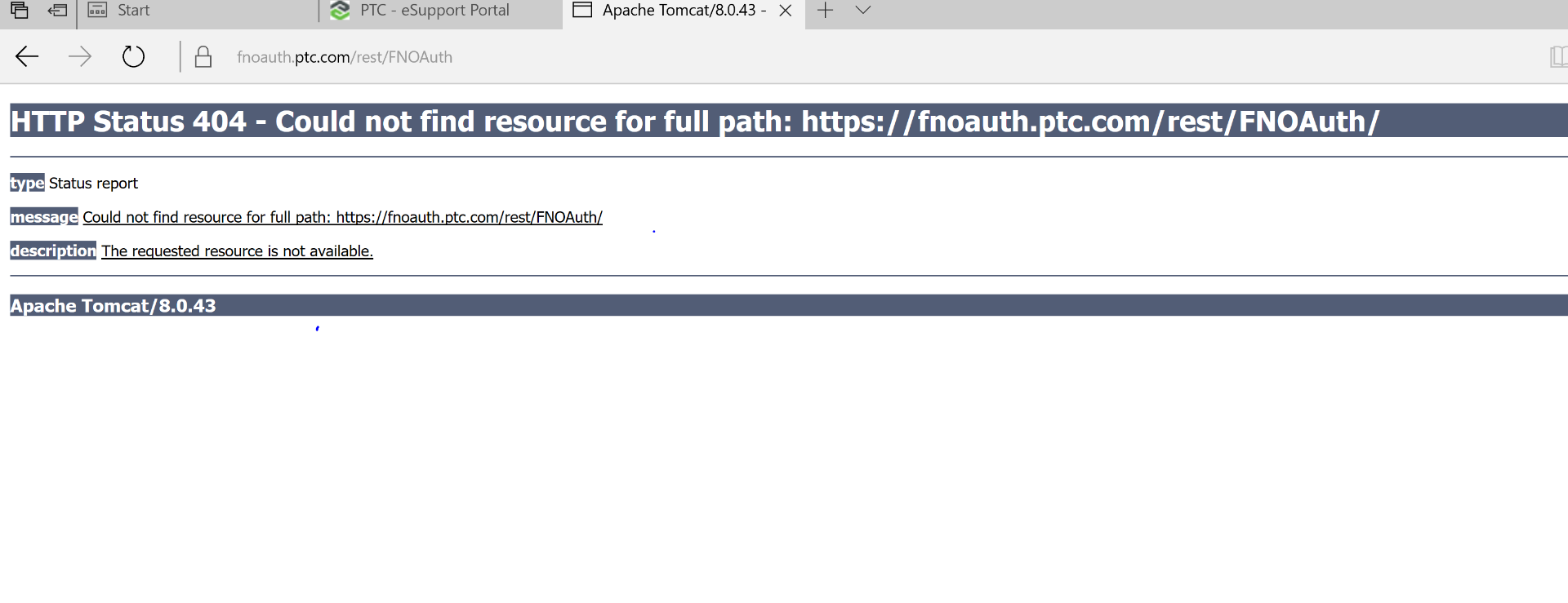

I am trying to download license.bin as instructed as part of thingworx installation..
getting failure message as posted below.
Any help will be greatly appreciated.
RM

Hi Rashmita, this could be a temporary issue. For how long have you been trying to download the file? If it has been a while you might want to reach out to your sales or open a license support case.

What happens when you click on the Download button on the License Management page? Ideally the license ( which is a .bin file) should get downloaded .
If you were able to download the file but faced issues while launching the Thingworx application , ensure that you have followed the below steps.
  • Download the license from the PTC Support site
  • Rename the .bin file to license.bin
  • Create ThingworxPlatform folder at the root of the drive where Tomcat was installed
  • Make sure the ThingworxPlatform folder has Read Write access
  • Place the license.bin in the ThingworxPlatform folder
  • Restart Tomcat and try launching the Composer again.
If you were not able to download the file at all , then please reach out to the sales dept as mentioned by Sushant.
