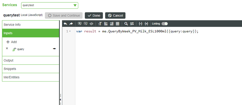

WeChat Screenshot_20191022101341.pngHi @PaiChung,
I try to apply this query into label chart. just change ESL 1000 ml to Whipping Cream 1000 ml.
but when I bind data filter widget, it is not working. Could you help me to figure it out?

Data filter widget if working properly will supply the query in json that you bind to the input parameter of your service
and then filter changed would trigger the service.
perhaps you can log out the query input parameter in your service to see if it is working right?
