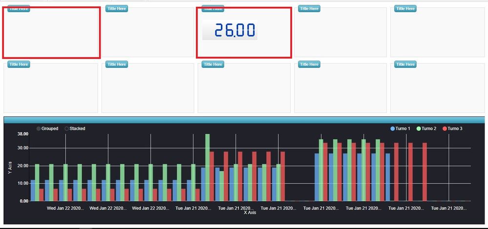

Hi everyone!
I have a problem with value display widget
At my dashboard I have inserted a display value and have bound with getproperties service
But the value on my variable do not work on my value display
When I run my dashboard the value do not work
To test I put a led display and bind with the same getproperties service and it worked well
Is someone with the problem too?
Regards
Leonardo

May be the property Simluador_Sim.. does not have a value(string) against it. The LED widget works fine since you have bound another property of Number type returned by GetProperties.

Hi @rjanardan
Thanks for your answer.
There is value in this property.
Sometimes work well both, but sometimes do not work more
