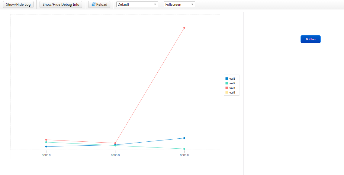

hi,
i have data shape that contains one date field and between 1 to 8 numeric fields ,the number of numeric fields depends on the specific user,
i want to show this data on a bar chart so that date will be the x-axis and the numeric fields will be on the y axis' .i bind the infotable fields to the bar chart. my problem is that even if a field is removed from the info table by a service  its still on the small window at the right of the bar chart that display the name of the fields, any ideas?!. for example in the following image i want to somehow remove val4 . it is there even though the infotable that fill the bar chart dont have val4 field

Time Series charts could do this for you by returning the data without a datashape and putting a check in ShowAllColumns.
However you lose a lot of flexibility and no selected row.
otherwise with a bit of extra work, you can use contained mashups to switch out to the specific proper mashup, that would mean 8 contained mashups though if you can have 1-8 series displayed.

Whoops that is for a Grid
I'm sorry, a TimeSeries chart has the ability to Auto configure itself based on a dataset.
it will find the first DateTime field and automatically use that for the X axis and any numerical value series will show in the Y axis
