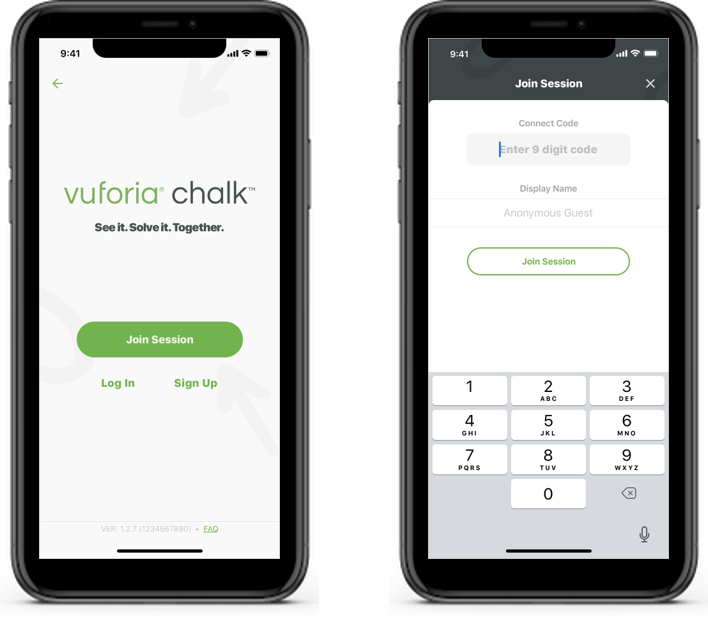

How it works:
USER A
User A clicks “Start Session” and either decides to share their view or see User B’s view, then issues a Connect Code to connect with User B by clicking the “Share” button.  User A can text or email the code to User B.
USER B
User B clicks “Join Session,” enters the 9-digit code, and joins the live session.  No login or registration is needed.

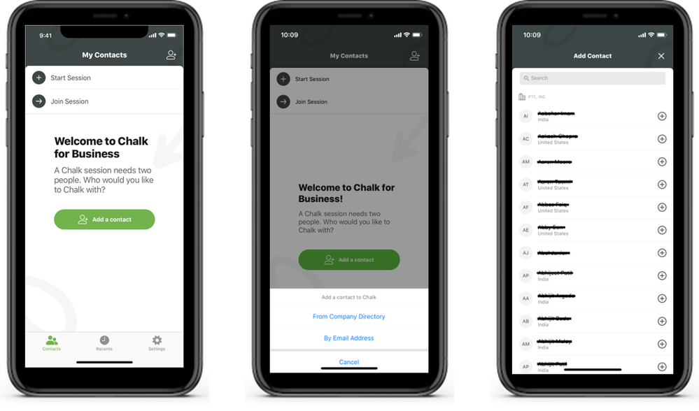

To initiate a call with someone within your organization:
To initiate a session with someone in your organization, click "Add a Contact" and "From Company Directory."  Locate the name of the person you want to reach.  Indicate whether you want to share your view or the contact's view.  Then Start Session.
