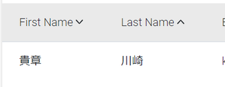

If a Chalk User is registered with non-English characters, Vuforia Chalk app on iOS will prematurely exit when "Start Session" is clicked.

Delete a registered user and once again add a user using English characters only.
A user name is cached and updating the user name doesn't fix this issue.
