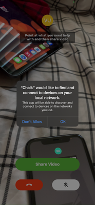

After updating to iOS 14 and Chalk 3.5.1, be sure to allow Chalk to connect to devices within your Local network. This allows for peer-to-peer delivery of audio, video, & images within the same network.
