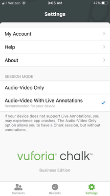

Live annotations have stopped working on multiple supported devices (iPhone 7) after the app update to version 3.1.1. Multiple tests have been made, but this feature is not available anymore.
Error message: "Live annotations are not currently available for this session."
What could be the issue and how can it be solved?

Can you confirm both devices being used during the Chalk call, and which was sharing their view? Please also confirm that 'Audio-Video with Live Annotations' is selected on these devices under Settings within the Chalk app.

Also the "Audio-Video with Live Annotations" option was correctly selected

Thanks for the clarification. During these tests do you get the "live annotations not available for this session" right away, or after going through the initialization step?
In Chalk 3.1.1 if you press 'Skip' at the beginning of the initialization, the call will default to A/V only.
