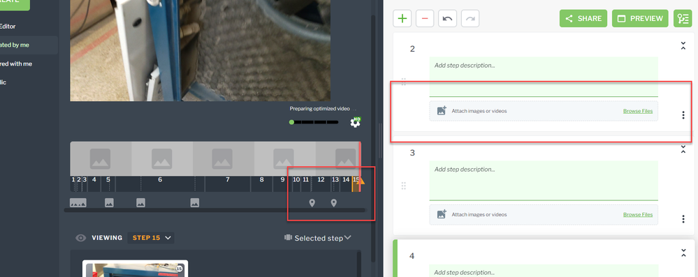

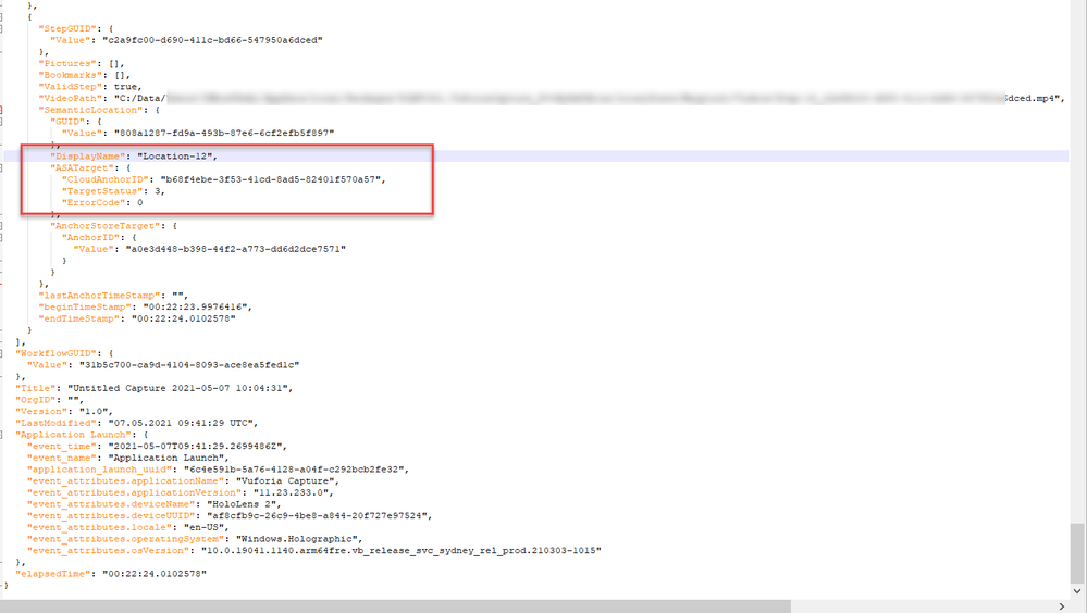

 we captured the procedure and 2 locations with Hololens.
Unfortunately I cannot add the locations to any step in the Editor. What was the issue? How to resolve it?

You'll need to use the 'insert steps' option to add the capture to your procedure. Once you've done this, you should see the locations listed as an option for each step.
