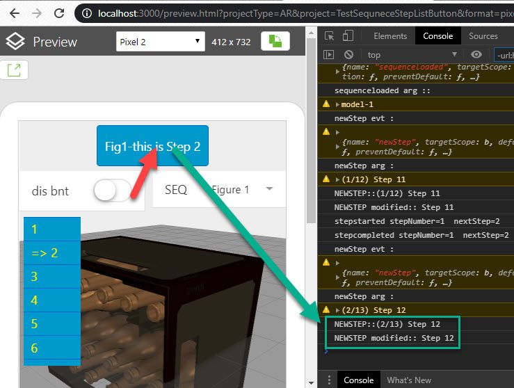

Hello @Ace_Rothstein ,
OK thanks now is clear.
So the following code will replace in the step message every text between "(... text ...)" including the breaks  '(' and ')':
$scope.$on('newStep', function(evt, arg) {
  console.log("newStep evt :");
  console.warn(evt)
  console.log("newStep arg :");
  console.warn(arg);
 // var labelId='label-5'
 // $scope.setWidgetProp(labelId,"text","NEWSTEP::"+arg);
console.info("NEWSTEP::"+arg);
var newTxt = arg.replace(/(?!<\")\([^\*]+\)(?!\")/g,'')
console.info("NEWSTEP modified::"+newTxt);
 $scope.setWidgetProp(labelId,"text","NEWSTEP::"+newTxt);
Hello @RolandRaytchev ,
                                          Thank you so much for providing such accurate solutions and helping us make better Augmented Reality Experiences. Your input on every case has been crucial and it was a great help for me. Much appreciated. Regards
