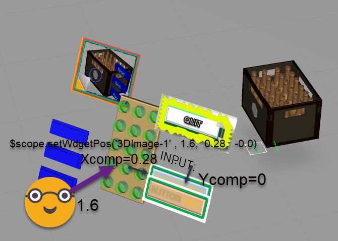

How can we make a 3D Widget on HoloLens visible in front of me everytime ?
100% helpful (1/1)
How can we make a 3D Widget on HoloLens visible in front of me every time ?

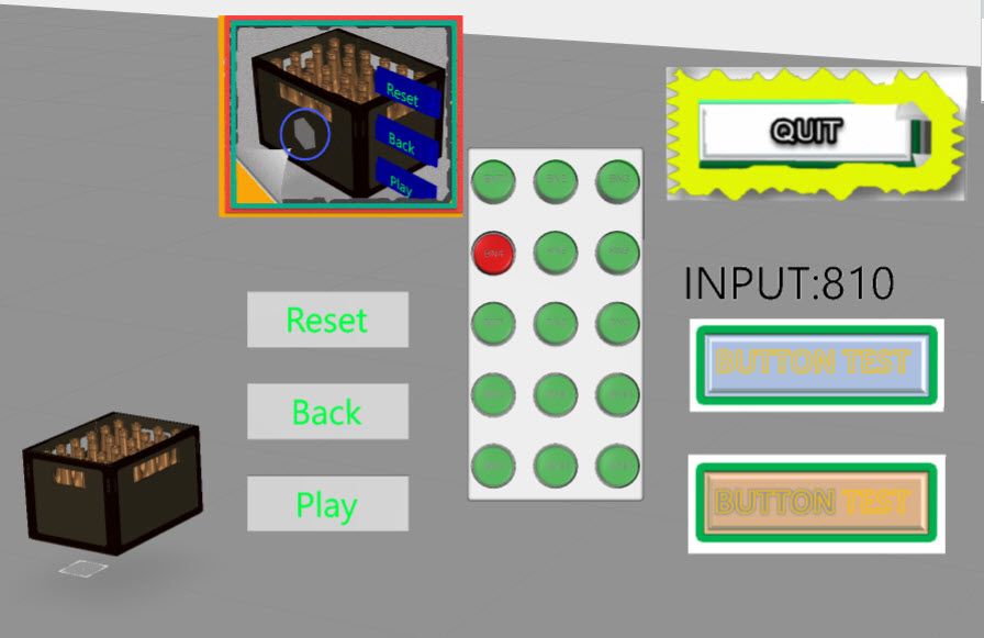

The goal here is to get a some UI containing 3D Widgets (3dButtons , 3dImages , 3d Labels and 3d Models) in front of current HoloLens view. For example after saying "show UI" the UI elements should appear in front view e.g. distance of 1,5 meters. Example:

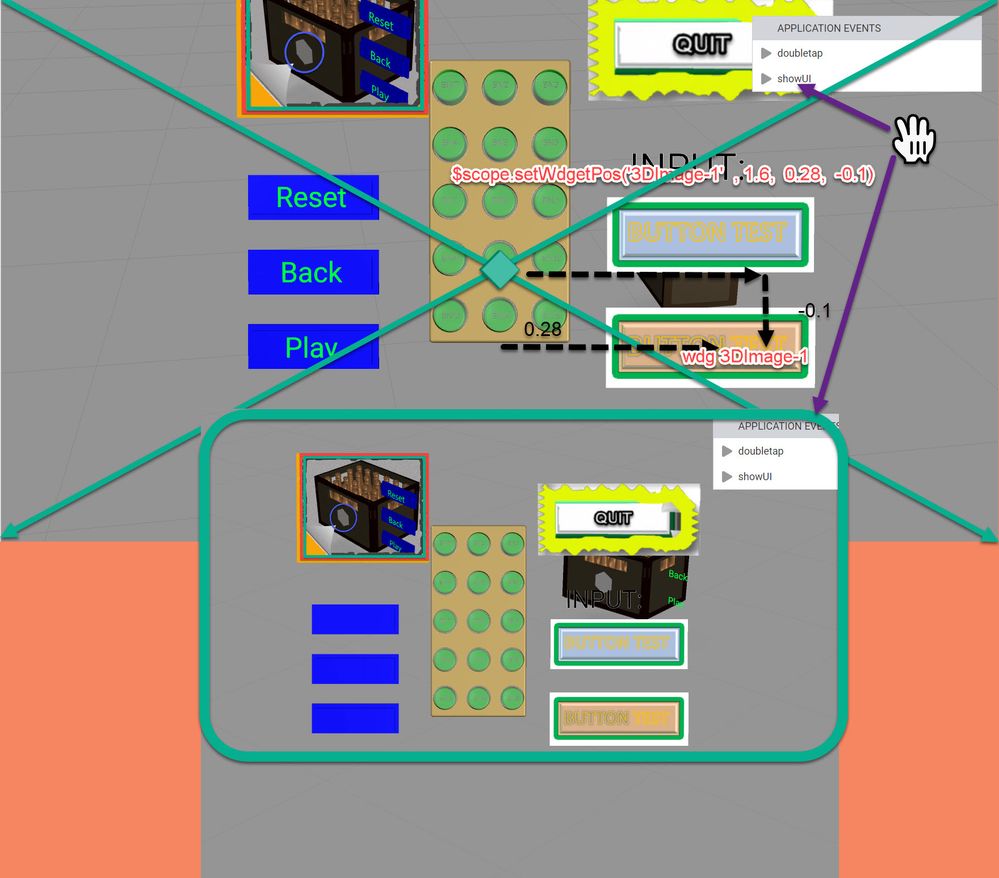

  • We already calucalted the rotation and now we need to calculate the x,y, z postion. This will be a point which is in front of use - along the gaze vector with particular distance and then x, and z corrinates of the view X and View Y vector:
$scope.setWidgetProp( wdgName,  'rx', rad2deg(EulerAnglesInv[0]) )
$scope.setWidgetProp( wdgName,  'ry', rad2deg(EulerAnglesInv[1]) )
$scope.setWidgetProp( wdgName,  'rz', rad2deg(EulerAnglesInv[2]) )
var eye_dir_norm   = vec_normilize($scope.eyedir)
//projected to normal
     var  eyeZaxis    	= eye_dir_norm;
     var  eyeYaxis  	= vec_normilize($scope.eyeup);
     var  eyeXaxis    	= neg_dir(vec_normilize(vec_product(eyeYaxis,eyeZaxis)))
     var  newCalc       = [];
     // here it will translate along the eye_dir and move in x and y axis
     for (var i=0; i<3; i++)
       		newCalc[i]= $scope.eyepos[i] + disScale*eye_dir_norm[i]
                                 + Xcomp*eyeXaxis[i] + Ycomp*eyeYaxis[i];
     //correction of the translation to the view plane in distnace of disScale
     $scope.setWidgetProp( wdgName,  'x', newCalc[0] )
     $scope.setWidgetProp( wdgName,  'y', newCalc[1] )
     $scope.setWidgetProp( wdgName,  'z', newCalc[2] )
So that now we can display the UI widgets with some calls like this:
     $scope.setWdgetPos('ShopingCard3DImage', 1.8, -0.25,   0.35)
     $scope.setWdgetPos('3DImage-1'         , 1.6,  0.28,  -0.1)
     $scope.setWdgetPos('3DImage-2'         , 1.6,  0.28,  0.05)
     $scope.setWdgetPos('3DImage-3'         , 1.6,  0.28,   0.3)
     $scope.setWdgetPos('3DButton-1'        , 1.6, -0.25,  -0.1)
     $scope.setWdgetPos('3DButton-2'        , 1.6, -0.25,   0.0)
     $scope.setWdgetPos('3DButton-3'        , 1.6, -0.25,   0.1)
     $scope.setWdgetPos('model-2'           , 1.7,     0,   0.1 , 1)
     $scope.setWdgetPos('3DLabel-1'         , 1.6, 	0.25,   0.14)

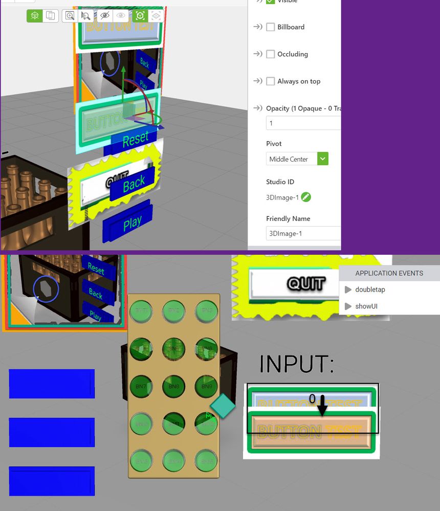

In this article I provided a demo project which is attached to this article as zip file. I attached also the javascript math function which I used.
 Where we have the widget name, distance along the gaze vector from the device and the X and Y position /X and Y view vectors /screen

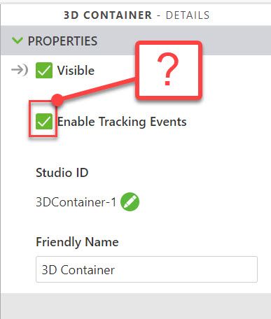

  • To be able to get the device  gaze , up(y) and the x vector we can use the 'tracking' event:
$scope.eyeMat=[];
$scope.eyeInvMat=[];
$rootScope.$on('tracking', function( tracker,fargs  ) {
    for(var i=0; i<fargs.position.length; i++)
    {$scope.eyepos[i]	=fargs.position[i];
     $scope.eyedir[i]	=fargs.gaze[i];
	 $scope.eyeup [i]	=fargs.up [i];
   $scope.eyeMat	=get_mat4x4_camera(fargs.position,neg_dir(fargs.gaze),[0,1,0]);
   $scope.eyeInvMat	= matrix_invert($scope.eyeMat)
   var EulerAngles		=transfMat2Euler($scope.eyeMat);
   var EulerAnglesInv	    =transfMat2Euler($scope.eyeInvMat);
  $scope.$applyAsync();
//////////////////////// finished tml3dRenderer.setupTrackingEventsCommand
The tracking callback function will save the current view vectors (gaze, up, postion) to a global variables which could be used later from the other functions.

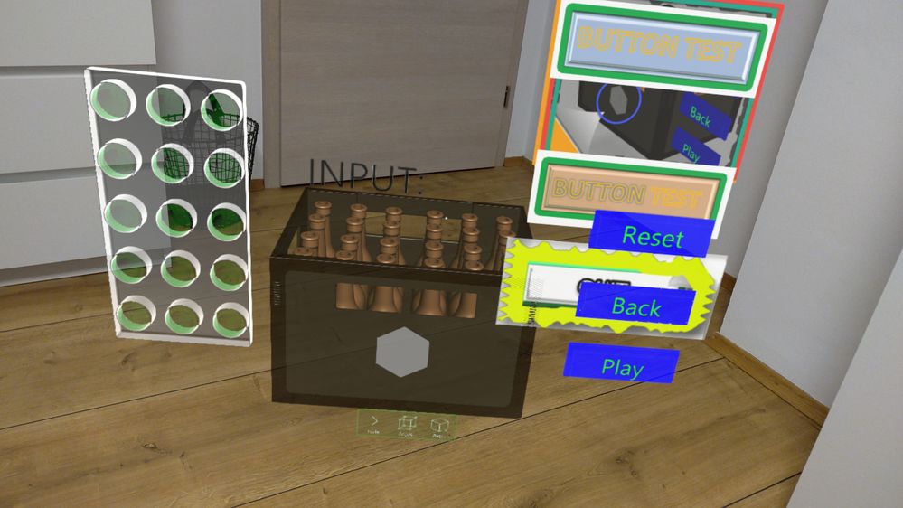

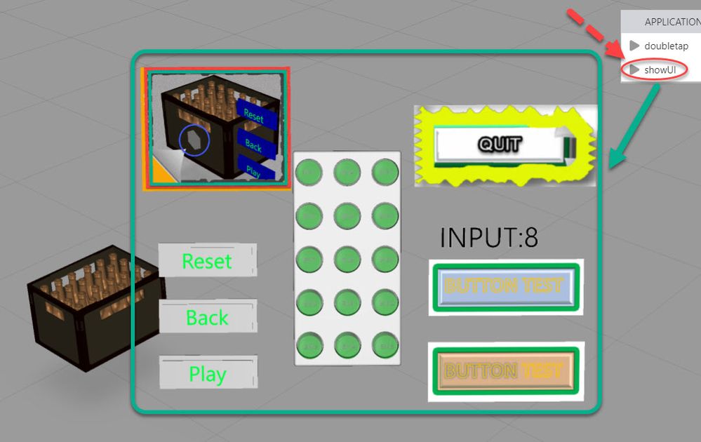

I created a demo project which is one possible example showing how we can implement such functionality. The sample project is for the HoloLens - I tested with on preview mode and on the  HoloLens 1 device and it was working fine. (- zipped project with password "PTC" - please, unzip it and import it to Studio)
A note about the attached file:
- the file project-"HoloLens3dFlexibleUI-article_ExampleProject.zip" should be unzipped to HoloLens3dFlexibleUI-article.zip - which is a project file for Vuforia Studio - demo project and could be imported in the Vuforia Studio UI. To unzip the project-example.zip you need a password simple: 'PTC ' - in capital characters
-the file: myMathFunc.zip contains the used mathematical function definitions (zipped js file) . The javascript file is also contained by  the Studio project/ upload folder.
When we test the project:

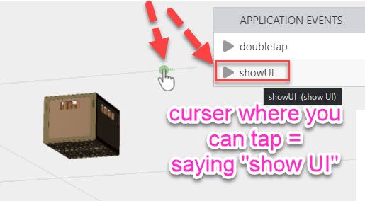

Where we see in front in the middle a cursor where we can tab or we can say show UI to display the UI:

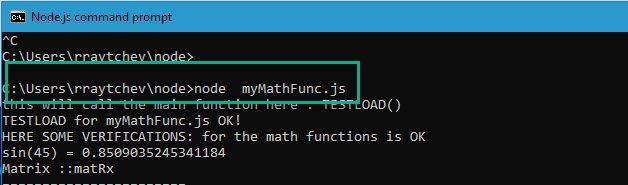

I attached a new version of the  myMathFunc.js (newVersion2-myMathFunc.zip)where rotation function and the verification was improved
Now the library could be verified by call in Node.js
..\node>node  myMathFunc.js
TESTLOAD for myMathFunc.js OK!
HERE SOME VERIFICATIONS: for the math functions is OK

Vector[length=6] :: TESt @ matRz
vec[0]= 0
vec[1]= 0
vec[2]= 59.99999999999999
vec[3]= 0
vec[4]= 0
vec[5]= 0
matTr=ggetTransMatrix(1,2,3)
Matrix ::matTr
Row[0]=:: m[0][0]=1.0000; m[0][1]=0.0000; m[0][2]=0.0000; m[0][3]=1.0000;
Row[1]=:: m[1][0]=0.0000; m[1][1]=1.0000; m[1][2]=0.0000; m[1][3]=2.0000;
Row[2]=:: m[2][0]=0.0000; m[2][1]=0.0000; m[2][2]=1.0000; m[2][3]=3.0000;
Row[3]=:: m[3][0]=0.0000; m[3][1]=0.0000; m[3][2]=0.0000; m[3][3]=1.0000;
Vector[length=6] :: TESt @ matTr
vec[0]= 0
vec[1]= 0
vec[2]= 0
vec[3]= 1
vec[4]= 2
vec[5]= 3
trfTestMat=transpondMat(mult(mult(transpondMat(matRz),mult(transpondMat(matRy),transpondMat(matRx))),transpondMat(matTr)))
Matrix ::calculated:: trfTestMat
Row[0]=:: m[0][0]=0.3536; m[0][1]=0.6124; m[0][2]=-0.7071; m[0][3]=1.0000;
Row[1]=:: m[1][0]=-0.6929; m[1][1]=0.6793; m[1][2]=0.2418; m[1][3]=2.0000;
Row[2]=:: m[2][0]=0.6284; m[2][1]=0.4044; m[2][2]=0.6645; m[2][3]=3.0000;
eulerOutput=transfMat2Euler(trfTestMat)
eulerOutputDEGREE=tconvEuler2Dec(eulerOutput)
Vector[length=6] :: TEST @ EulerVecDeg at LOAD
vec[0]= 0.3490658503988659
vec[1]= 0.7853981633974483
vec[2]= 1.0471975511965976
vec[3]= 1
vec[4]= 2
vec[5]= 3
Vector[length=6] :: TEST @ convEuler2Dec:: eulerOutputDeg at LOAD
vec[0]= 20
vec[1]= 45
vec[3]= 1
vec[4]= 2
vec[5]= 3
trfTestMat1=getTrfMat(20,45,60,1,2,3)
Matrix ::calculated:: trfTestMat1
eulerOutput1=transfMat2Euler(trfTestMat1)
eulerOutputDEGREE1=tconvEuler2Dec(eulerOutput1)
Vector[length=6] :: TEST @ EulerVecDeg1 at LOAD
vec[3]= 1
vec[4]= 2
vec[5]= 3
Vector[length=6] :: TEST @ convEuler2Dec:: eulerOutputDeg1 at LOAD
vec[0]= 20
vec[1]= 45
vec[3]= 1
vec[4]= 2
vec[5]= 3
Library test on LOAD finished!

I tested it on the HoloLens 2. It works in the browser preview, but unfortunately not on HoloLens 2. What am I doing wrong?
I need a UI solution for the HoloLens 2.
Here is a picture of how it is displayed at the moment.
Hello  @Lucas ,
thanks for your feedback!
So far I see the picture (it is HoloLens 2? device right? ) and it is invertet - means that  you will see the backside  of the UI (assembly which implements the 3d buttons panel - is inverted and other things are working - on the correct plane but also moved.
Could you please, clarify. I did created it some time ago and need to check more detailed to understand what is going wrong on the HoloLens 2. My first guest is that we need to rotate the 3D objects about 180 degree. I remember that after some update there was a problem and the project was not working (also in Preview mode) - so I did recreated it and maybe there are some mistakes. I test that it worked generally on preview without further to check if everything is on the correct place also on the eyewear device
How do you want to use this – mean what kind of target (space target, model target or thingmark)
Additionally I want to point that the project was created at time where we did have this functionality on the HoloLens yet. In the meantime, we have new functionality 3D panel which is container for other 3D widgets and it will follow you display and could be pin on a particular location. Maybe it could be convenient to use it

But OK let consider how this function work $scope.setWdgetPos()
  • it receive arguments widget name , the disScale Xcomp, Ycomp - coordiante
             In the example
$scope.setWdgetPos('3DImage-1', 1.6,  0.28,  -0.1)
  •  to understand the difference I will use also the example
    $scope.setWdgetPos('3DImage-1', 1.6,  0.28,  0.0)​
distScale is argument for the distance from your possition (device ) along the Eyevector, so larger values will increasd the distance to the plane where the UI will be located.
Xcomp
Ycomp
are x,and y coordinate of the component.
You have to see that the center of your device screen has a normal vector which is the eyevector and this is the x=0,y =0 zerro point if the view plane. The view plane is  flat plane paralell to you device - if iPad then paralell to the iPad screen. And here you need the flat  coordinates in x,y of the component in meter so far I remember , So here is the postion of the 3DImage-1 shift to the right =0.28 and shifted down (minus) -0.1.
So we can see that when we call the showUI it will move all elements paralel to the view plane (through the eyes - if  the device is a tablet then this is  the plane of the screen) . The plane where the element should be displayed is shift paralell to the screen plane in distance of 1.6 m. the center is 0, 0. And 2.8, 0.0 is the element moved to the center , right

working perfectly with SPATIAL target, but now I'm developing it in an experience with a THINGMARK and it doesn't work properly.
I tried to debug it and I found that the
  event is not fired and it's the event in which the eyepos, eyedir and eyeup values are set.
Does it work for you?
Thanks in advance,
Best regards
Hi @aletenti , did you set the 3D container property enable Tracking event?
if yes then need to check it furhter....
Hi Roland, you are right... I forgot to set that property.... 🙂
Now it works, thank you very much!

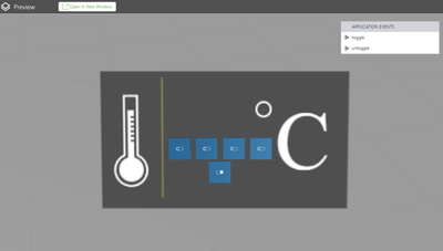

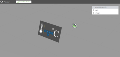

Here's some screenshots:
1- initial view
2- 2nd view
3- activated auto-follow
As you can see, all the elements stay linked with the "father".
