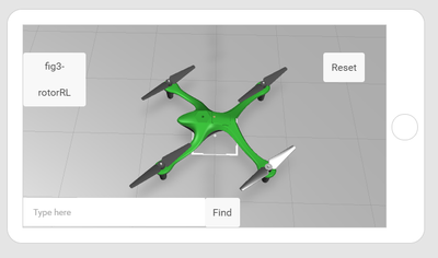

Dear support team,
After clicking on a part like the rotor in the 3D-Guided Service Instructions demo experience, it gets highlighted green, but after that goes away it looks shinier. Why does it not go back to "normal"
I have tried to adapt the on click ionic popup for a customer experience, but it does not work in view app, it only works in the preview. What could be the problem there? I am using a Iphone SE 2. I can't share the experience right now because of a non disclosure contract. This is the code I'm using:

The shader issue is still there, it can be viewed in the image below, the bottom right rotor on the screen has a lighter or shinier color than the other ones, after I've clicked it.
I've added the project file to this reply.

Hello Alex,
I have tried on my laptop the Project provided.
Please see the attached video.
I am not able to reproduce the issue in Preview.
So, I believe that's an issue who is specific to some computers.
Do you have upgraded video graphic card driver ?
As a shader is sent and executed in GPU on graphic card, it might be a root cause of this problem.

Hi Samuel,
Thanks for your reply. I did some digging and found the issue causing the bug.
If I add this piece of Java Script:
$scope.$on("$ionicView.afterEnter", function (event) {
    $scope.setWidgetProp('model-1', 'shader', 'Default');
The "Default" shader is sett in the beginning and the party look the same after clicking them. So the "Default shader is not actually the shader set as default in my version of Vuforia Studio.
The only problem now is that the "Default" shader looks very bad on non metallic parts. It gives everything a metallic grey shine.
I solved it by changing the "Default" to "" in this JS Part:
        //set the properties of the TML 3D Renderer to highlight the selected item using a TML Text shader. "green" is the name of the script for the TML Text.
		tml3dRenderer.setProperties(item, hilite === true ? { shader: "green", hidden: false, opacity: 0.9, phantom: false, decal: true }
                                                     	 : { shader: "", hidden: false, opacity: 1.0, phantom: false, decal: false });
