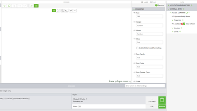

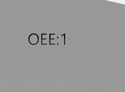

I'm connecting my 3D lable to a Thing and displaying live data... This is working fine.
What I can't seem to figure out is how to get the Data and a Lable to Display on the canvas eg "Tank02 Level: {data Value}"...
As soon as I go to preview the Label Text just gets replaced with binding data...
Any help or guidance would be greatly appreciated...

Yes you can use this method also, You have to add filter to value.
Swapnil More
Swapnil More
ppierce
(To:Swapnil_More)
Thank you @Swapnil that’s exactly what I need.
