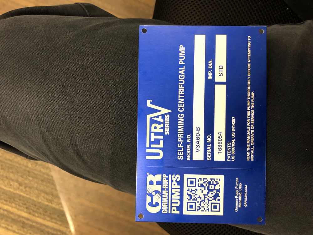

I'm running the free trial version for vuforia studio and very new to the mobile app. I am experimenting and wanting to display a CAD model on a QR code that I already have. Would this be possible for me to setup and if so how do I go about doing it? Any pointers or help if I am able to use this example of the QR code I have already or is it not possible?

- one option is to use your Image Target. So you can make your project able to be used offlen. So when you load it first time on your device you can then downlaod it. Later you can open it via the library tab. Then you can scan you label via scanner  and then used the scanned image as image target. So, when the project is called then you have to set the position by scanning your label with the QR code. - here the QR code is interpreted only as with as part of the whole picture  - the scanned label.
- an other option is - when you create you project - to generated a new QR code of the project. This is the QR code which appear if you select the option -> share > share experience- this is possible option to find/scan your project. In this case you have to incorporate the new QR code on your label. And for the position of your model you can use a spatial target - so mean any surface to set dynamic the position or you can scan the label and use it a s image target

Also I'm just wanting to see if I can replace the ThingMark with the picture I uploaded instead? Because when I scan the Blue Card QR code I want to use it in Vuforia Studio to add a CAD drawing. Would that be possible with your steps you listed below in an easy manner?
What is this QR code - reading it will say some thing like : http://for.co/104yt
The question is could you replace it on this label by another QR code which is generated by Vuforia Studio.
So 2 of  the points I mention in the previous post are:
1.) set the project as public and as offline - so you can download it later on the mobile device
2.) create an experience QR code:  action : share the project
So again, the question is - could you replace on your label the QR code with the QR code of your project...
This QR code contains a link which is specific for your project - contains server and project reference - this is the link on the left side in the picture "Experience URL"

The QR code is going to our website of the customers product. So when you scan it with just any normal QR Code Scanner it will show you the Serial Number and Product Information. But I was wanting to see if simply just taking a picture of the image I have down below and replacing it with a ThingMark was possible. Unfortunately I can't replace it with a Vuforia QR code since our laser software that cuts the metal of these boards creates that. Plus my company is really old school mentality of them is if it isn't broke don't fix it.

So I think in your case is the best solution for your to make your project able to download /as shown in the picture in previous post -> offline checkbox in on.
You can send via share projects your published experience project to other customers via e-mail So they could click the link there in the mobile device or scan the QR- code and then this will load the project (also is possible if you want that project is not public to ask for credentials)
So , for the positioning of your project you could use an image target of your scanned label (the blue card ..,. without the circle there…). Customers could also download your project and then they could use it without internet connection. Your customers could start the project when one time it was downloaded from the library tab of the Vuforia View app.
