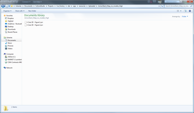

Hi @awilber ,
at the first view I do not see any difference to my code. I checked the project and it working fine in preview so that the code should work in the original context.
1.)So the sequences (pvi) are embed in the pvz file / so you do not need to extract it
2.) when look in the code:
$scope.app.loadsequence = function()
$scope.setWidgetProp('model-1', 'sequence', "app/resources/Uploaded/l-Creo 3D - Figure 1.pvi");
twx.app.fn.triggerWidgetService("model-1", 'play');
// it will set the sequence to TestMYFigure1
// and will play it
///////////////// start the code when model widget is loaded -complette
 $rootScope.$on('modelLoaded', function()
$scope.app.loadsequence();
so the code will work if your model widget is named "model-1" and the  "sequence” property if it  is set  to "Figure 1" figure. So if you set it in Studio User Interface  it is displayed as "Figure 1"
Also  your model “src” property (in UI Resource) should be set to the correct pvz file. The model-1 is the name of the widget.
I tested in the original project (for HoloLens) and it works.

So I took your code and I put it into my .js location.
My model is named model-1 (just as yours was)
When I got into the uploads folder I have 2 .pvi files under a folder.  Do I take those .pvi files and load them down to the root "upload" folder, or leave them embedded in the folder below upload?
And then my code I put in there is as follows:  What am I missing?  I can't seem to get it to go.
