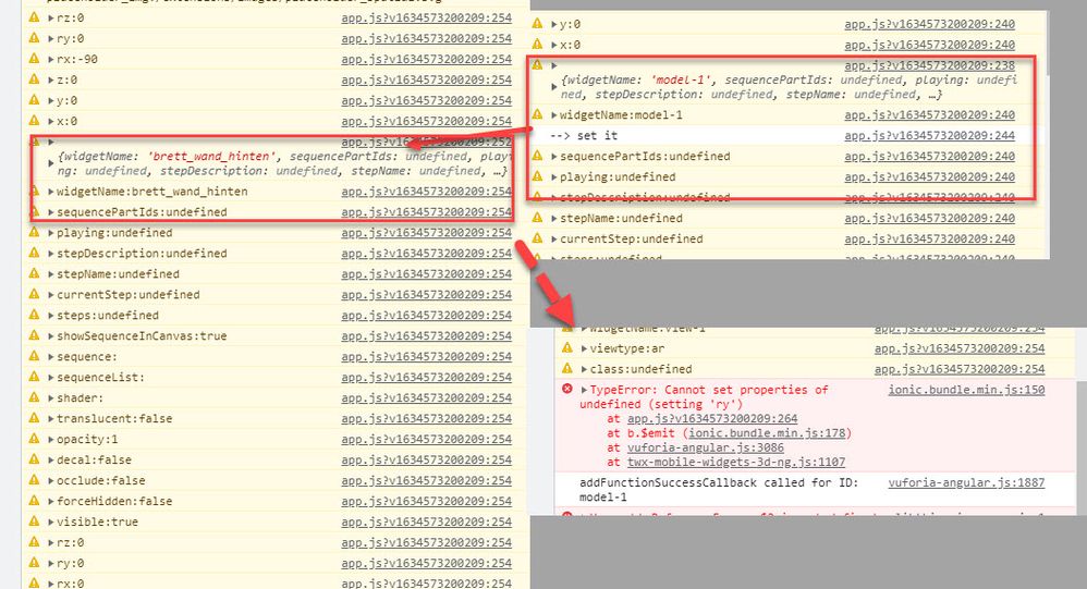

so far I know , to change the Studio Id at runtime is not possibly because it is read only and it  could be changed only in Studio Edit UI
For example when I test it something like this:

This code above  will try to change the modelWidget ID name. At the first moment it seems that it works but later trying to access this via the new name will fails and the name will be reset back to old name when we refresh
The question is here what is the reason that you want to do this automatically.
If the reason is that  you want later to search in some javascript using the  pvz model or unique part of the pvz name - so this could be done be done by javascript
