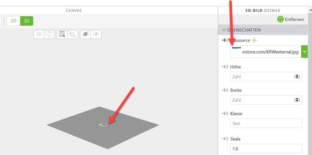

In Studio you can enter any image URL in the "Resource" field for the 3D Image widget, it can seem like that is only a drop down box of your uploaded resources by you can type into it.

For some reasons i cannot get it to work with the external link: The small preview is there but after pressing "return" or "enter" no image is inserted into the scene. (Chrome and firefox). When i hit enter, the topmost ressource image is taken, not the link.preview.jpg
You are correct and I would call this a bug and maybe @tmccombie can make a ticket for it. If you hit enter after pasting in your URL it will pick the top value in the resource list but if you paste the URL in and then just click somewhere else on the page it will take the value.
