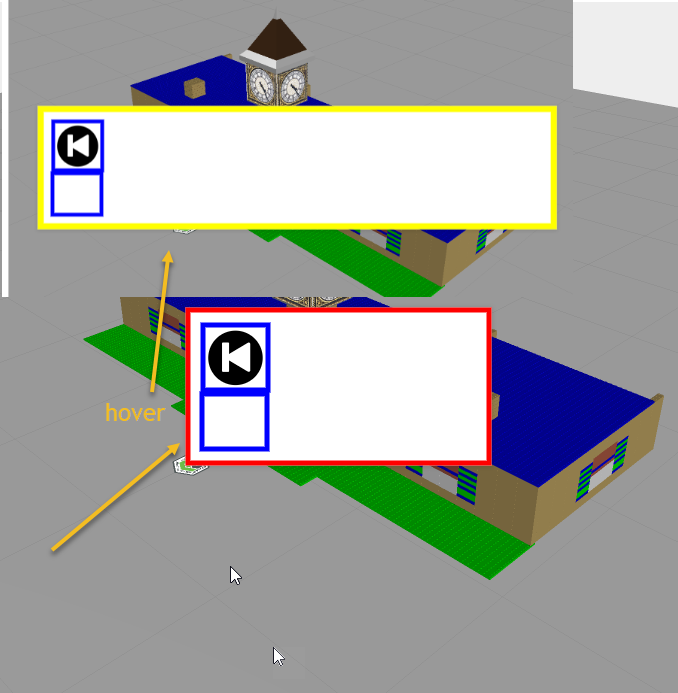

in generally it seems that popup widget is working with  style .
For example the following style:
.test1{
width: 40%;
border: 5px solid red;
-webkit-transition: width .35s ease-in-out;
transition: -webkit-transform .8s cubic-bezier(.455,.03,.515,.955);
.test1:hover{
width: 90%;
border: 8px solid yellow;
adding to Applicaiton and then set the popup class property will work as expected:
So means  that the style definition is working fine for this style in this  case.
I tried to use the your style definition  in chrome as general style but it was not working.
