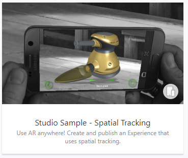

You should look at the sample project that comes with Studio for an example:

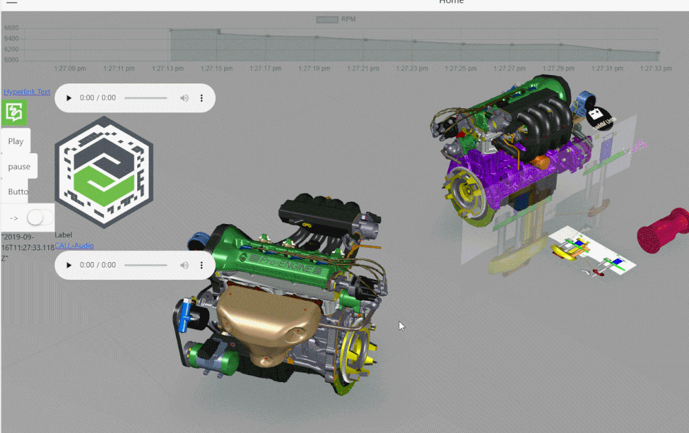

There is also an option to call the project in preview mode, which may be could be helpful in your code. The syntax of the URL is <ExperineceServiceServerURL>/ExperienceService/content/projects/<PROJECTNAME>/indes-desktop.html?expIndes=0/<VIEWNAME>
example of usage:
https://mrerot7o.studio-trial.thingworx.io/ExperienceService/content/projects/bla/index-desktop.html?expIndex=0#/Home
This will show the experience with all features without camera in the mobile browser app:

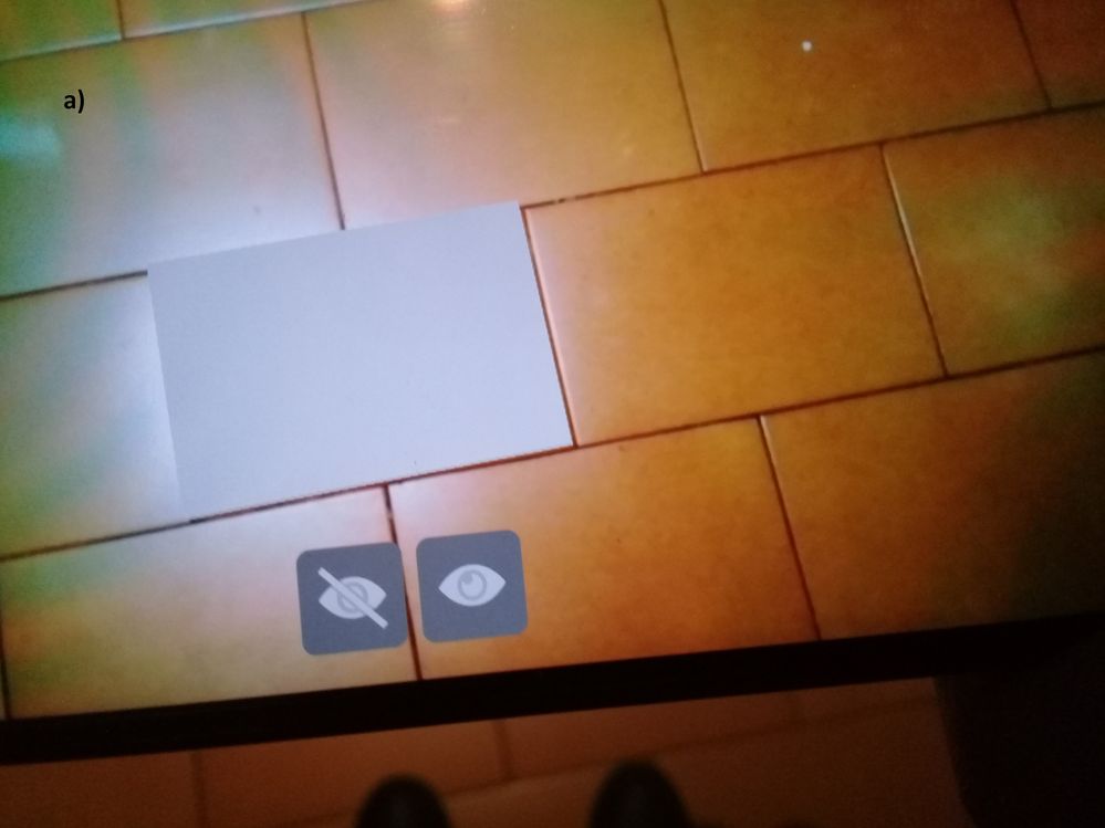

Hi Allan,
I drew a white floor tile only for testing.
It could be that I am doing something wrong, but sometimes when you put the tile the scale is near 1:1 (a), and sometimes the scale is far from 1:1 (b)
