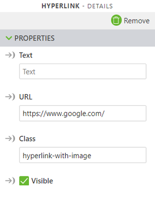

I guess there are may ways to do it, one being  using CSS.
First drop a hyperlink on the 2D canvas where you want it.
Leave the Text property blank, set its URL property to the URL and give it a class, such as hyperlink-with-image
Then upload a graphic resource in the RESOURCE > Uploaded section, such as ptc.png
Then go to STYLES > Application and add some CSS as follows:
.hyperlink-with-image {
display: block;
background-image: url(#{$resources}/Uploaded/ptc.png);
background-repeat: no-repeat;
background-size: contain;
width: 100px;
height: 100px;
