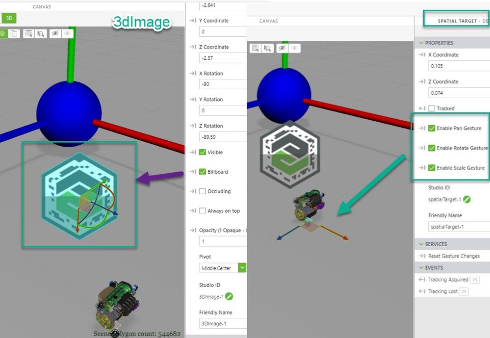

Currently you can use Pan , Rotate and scale for 3d elements in experiences with spatial targets. So, for example if you use 3dImage Widgets (e.g. with Billboard property set) you could have a similar effect.

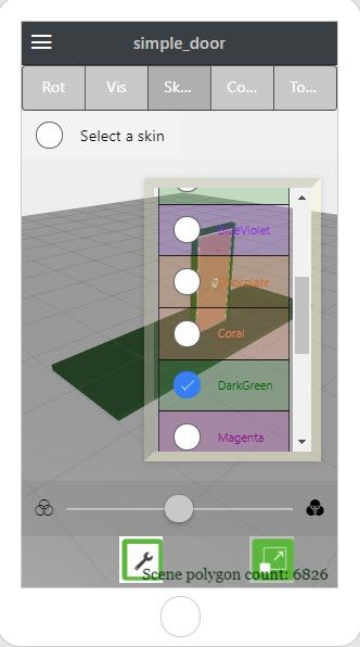

I remember that when we have many 2d elements on a popup widget then the popup provides automatically scrollbars. Example:

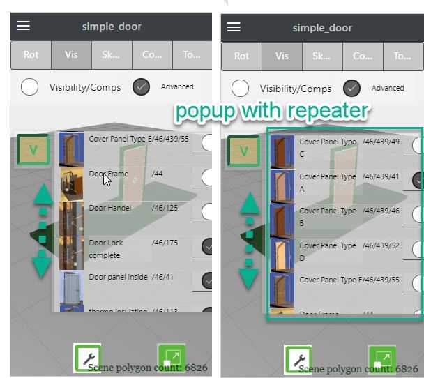

or you can use an repater having different widget / also images:

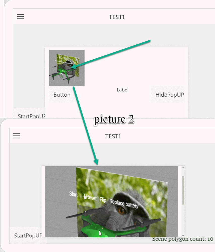

I have a zoom buttons ( in / out ) and a single image in a popup
I want to enlarge the image with the zoom button and move the image to the scroll bar.
So far I know dynamic zoom is not possible because the width and height property could be set on start time but not change later dynamically.
One very simple option should be to use 2 different image widgets image-1 and image-2 and then define for each of them a click event with some code like this:
