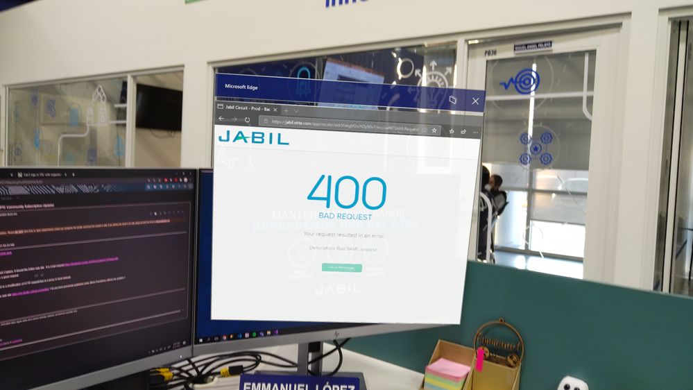

I've been trying to make some procedures in my HoloLens, but when I try to sign in it throws the error "We can't connect to the service you need right now. HTTP 400 error".
Is this an organization problem or a VEC application problem?

An HTTP 400 error means :
  1. App is trying to access to a web site. In case of Vuforia Expert Capture, it should the Editor web site.
  2.  It is a bad request https://developer.mozilla.org/fr/docs/Web/HTTP/Status/400
          In your use case here, Vuforia Expert Capture should create a good request.
          So, the possible root causes can be :
  • A bug in Vuforia Expert Capture
  • A network problem like a cut or a modification of HTTP request due to a proxy in local network
To start the investigation :
  1. In Hololens, in Edge web browser, are you able to reach this web site https://go.studio.vuforia.com/editor ?
  2. Id you have previously published some others Procedures without any problem ?

I tried to open the website, but it throws the same error after sig in:
The message says: "Bad SAML request".
I have published procedures in the PC, but I can't in HoloLens.

    I guess that Jabil Okta is a software to manage SSO as Identity Provided and it is used by your company.
    It is explained the issue about SAML bad request.
    SAML is used in SSO.
     Here for any reaon, SSO setup from Vuforia Expert Capture is not correct or request is modified on the fly.
     It would recommend to report that to your IT.
     Your IT should open a case to PTC Technical Support and we will be able to investigate deeper.
