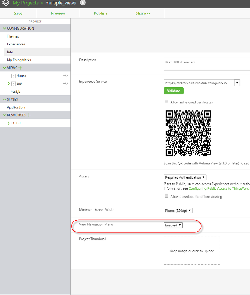

Hello Everyone
When I add second view to my  experience.The menu bar automaticly is added to User Interface.
I dont want this menu bar in my experiences  I will navigate it by clicking buton.
How Can I cancel it?
sdidier
(To:RAMO)
Hello Ramo,
Please follow these steps :
  1. In Vuforia Studio, in your Project
  2. In PROJECT panel, in CONFIGURATION section, in Info menu
  3. In the View Navigation Menu list, select Hidden item
  4. Click Save button

RAMO
7-Bedrock
(To:sdidier)
Thank you very much Samuel.
