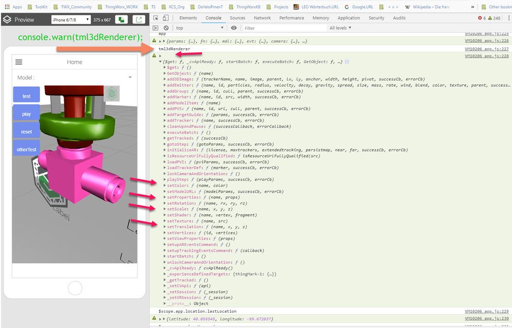

some addtional comment there. So in this case the object tml3dRenderer is good canditate to be used here. Because is not documented /declared as public API we could discover by ourself.
This object is acctually the render object and it is injected as tml3dRenderer in the twxViewControllersModule in the app.js

I do not believe that we can expect that this name could change but there just in case an other other general method to received this object:
$scope.renderer = window.cordova ? vuforia : $injector.get('threeJsTmlRenderer');
console.warn('renderer');
console.warn(renderer);
in this case the printing in the console will be the same as shown in the picture above
So if you want to use for examle the method translate to move dynamical a component
tml3dRenderer.setTranslation('model-1-/0/0/3/2, 1.0, 1.0, 1.0)
//moves the component with idPath /0/0/3/2 of the model-1
//to x=1;y=1 and z=1

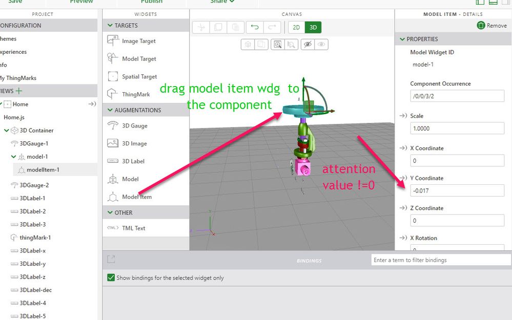

But sometimes the position could be not as expected, because it is regarding to the 0 coordinates ,but not to the current component position - so means when we create a model item widget for this component some time the values of x,y,z and rx,ry and rz could be different from zero
As shown in the picture above we can find out what is the current position - so when we create a new modelitem widget in this case the values of x,y,z,rx,ry,rz properties mirror the current component position.
