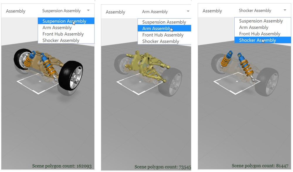

I want to change the buttons to be used according to the selection i made in select widget. Any idea how can i achieve it?

Hi @manojpandey ,
what should happen here? I see there are some models already uploaded in the folder and you have a select.
Do you want to select these models - for display?
If no then please, let me know what is the issue - Pease provide more detailed information about the problem
if yes - so, I will suggest  to having the following behavior:
To use the following code:

Actually I want to place some buttons at the bottom of screen and I want that when i choose 'suspension assembly' some specific buttons should be displayed and when I choose other option such as 'arm assembly' some other buttons  should be displayed and the previous one should hide.
Also when i switch window, operation done by the previous button should be disabled.
