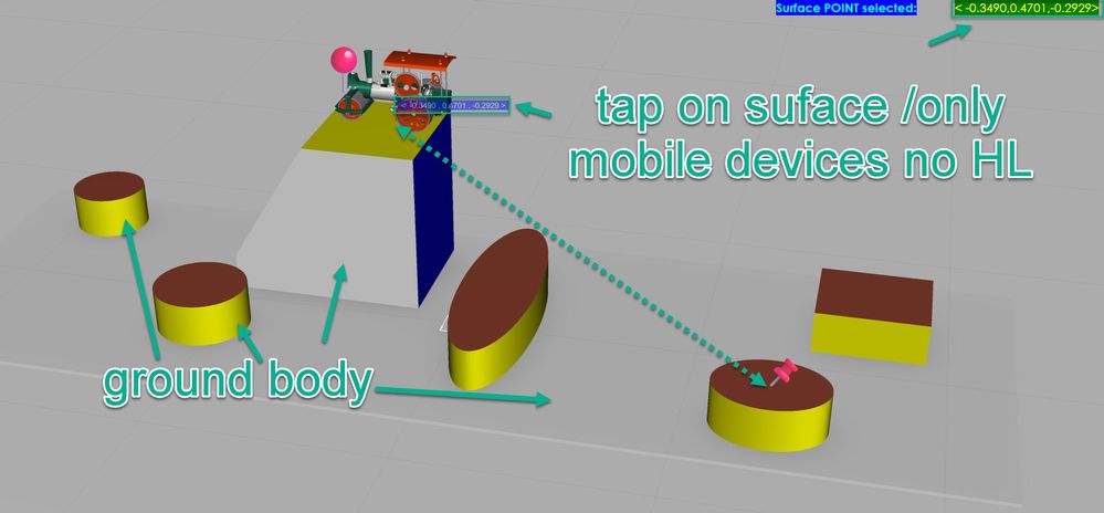

in the sample model the main issue was there  the dynamic wayfinder functionality but there is also a function for  user pick that will move a coordinate system   to the pick location.  And that was meant that this could be used to move the position of a  model (widget) - e.g. tap on surface and use the "picked" point on another model widget to specify  the new position of the model widget. I simplified the example having only that functionality
e.g.:
there are 2 model widgets
1.) is the ground model  used only to specify fia click on surface  the position of the model 2. You can make it invisible and then switch to  visible only during the positioning
2.) second model is the AR model that should be moved.
That workflow is working only on mobile platform , no on HL
So then clicking on  any surface  will move model 2 to the clicked position
so attached the simplified Studio project here
