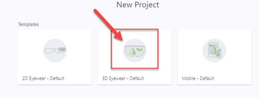

Hi @Velkumar ,
I am sorry , may be ,I overlooked some thing or some new functionality but for me is not clear what you mean with "in HoloLens project but not in 3D Wear project."
So far I know the 3D wear is a HoloLens project. I created it  by selecting 3D Eyewear- Default.
Is there a another option what you did use?
What is the end device what you try to use?
Did you test this project?
https://community.ptc.com/sejnu66972/attachments/sejnu66972/tkb_vuforiatechtips/107/6/HoloLens3dFlexibleUI-article_ExampleProject.zip
Hi @RolandRaytchev
Sorry I have mentioned project type wrongly. Its 'Mobile - Default' project.
End Device - Android / iOS
Yes I tested that project, I'm able to print 'fargs.position' in Flexible UI project. But when I tried same script for Mobile, its not printing 'fargs.position' in debug window.
