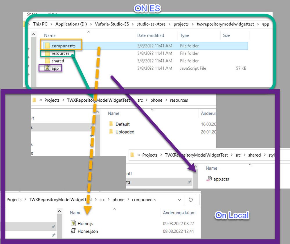

As the title says, I have a few experiences running 100% OK. What I need to do is copy them to make modifications. I tried doing it by hand, but when I try to open one in Studio, the software just hangs at the "Initializing Project..." screen and it never moves forward. Does anyone know what I am missing? Surely, an admin should be able to get a copy of an experience, correct?
Hi @HectorAtLmco ,
how did you try to copy the Vuforia Studio Project to the local machine? I believe you simple try to copy  the directory form the Experience Service as project? Or did you try some other methods?
 But I believe to copy project directory form the ES folder is the only one available option . We could find the  folder as specified in the project section if the configuration json on the ES installation e.g.
 "projects": {
    "storePath": "D:/Vuforia-Studio-ES/studio-es-store/projects",
    "staticOps": {
      "maxAge": "1 second"
So when we check  the experience servrer  folder it seem not to be the same - compared to the i  project folder in the Studio local installation - sample project:2022-03-16_20-06-07.jpg
So if you do not use External data - I think the best option will be to create a new project and to replace the files /data form the mentioned folders
View.js and View.json e.g. Home.js and Home.json and all resources but also  app.css file for the styles
If you have a Thingworx data then you need also  Data.json, metadata.json and Device.json here in the example form the folder
Local
\Projects\TWXRepositoryModelWidgetTest\src\shared\components
ES Server
D:\Vuforia-Studio-ES\studio-es-store\projects\twxrepositorymodelwidgettest\app\shared\components
  Possibly this is not the only opton available -and somebody could share it but , I used this workaround sometimes and it was working for me.
