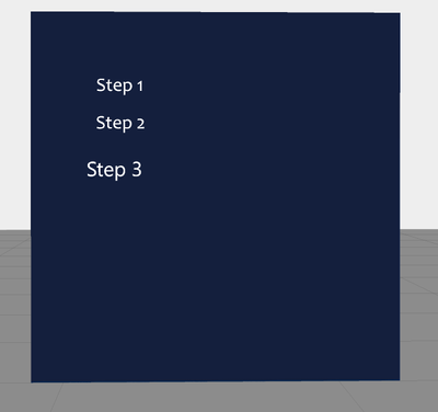

I have a list of sequence steps named as below:
Step 1;
Step 2;
Step 3;
To be able to finish the whole process, one must done the first step then follow by the other two. My concern is, when I in the second step process, step 1 and step 3 must be disable/freeze until I finish the current step (Step 2). Next, when I finish the second step, I want to jump to step 3 but disable the other two step before (one step at a time).
Need your advise regarding this matter. Thank you.

dsgnrClarK
(To:KM)
With 3D eyewear, 3D Button and 3D Label has NO property such as Disabled.
Therefore, Visible is the only option.
$scope.$watch(
  'view.wdg["model-1"].currentStep',  function(val) {
    switch (val) {
      case 1:
        $scope.view.wdg['3DLabel-1'].visible = true;
        $scope.view.wdg['3DLabel-2'].visible = false;
        $scope.view.wdg['3DLabel-3'].visible = false;
        break;
      case 2:
        $scope.view.wdg['3DLabel-1'].visible = false;
        $scope.view.wdg['3DLabel-2'].visible = true;
        break;
      case 3:
        $scope.view.wdg['3DLabel-3'].visible = true;
        break;
      default:
        break;
Also, a function to play specific step is required.
It is tested on Hololens 1, works fine.
