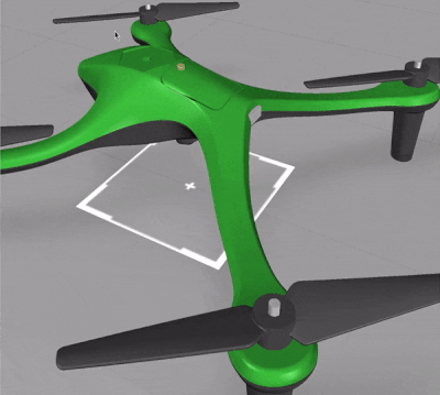

Good Point!. So customer may need to add the effect in Creo illustrate.
The effect is done by Javascript in Vuforia Studio.
I guess it would be possible to change the scale simultaneously, but haven't found out how.
