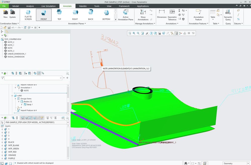

So here imported the step file you provided in Creo Parametric 11 and it could handle the PMI annotaitons

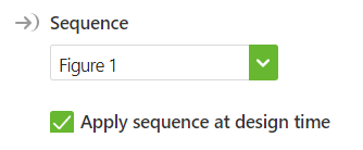

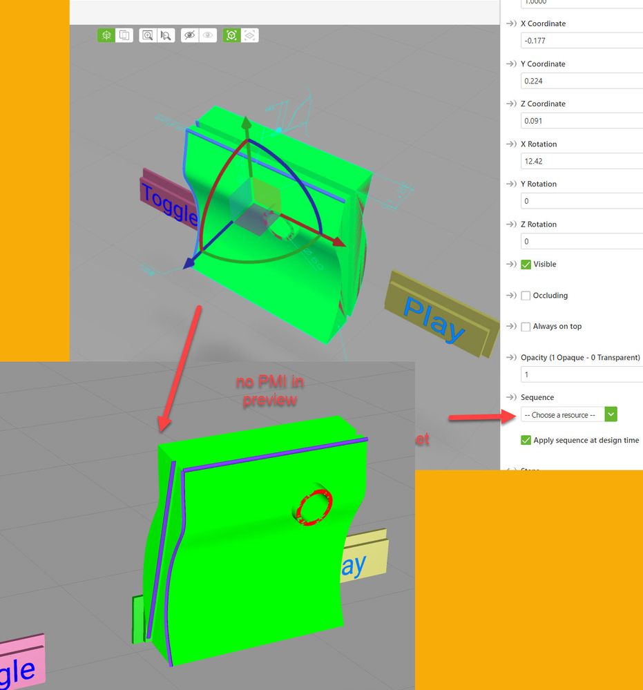

  • but it is important that the pvz file should  contain a sequence - because otherwise you can not set the sequence property in Studio and without setting it , so far I see it will not work -  it is sufficient when only empty sequence is availible ->  you can delete all steps.

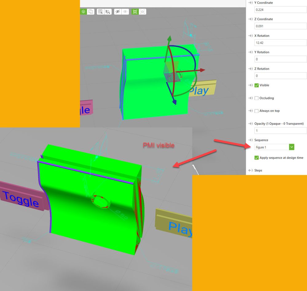

  •  I checked it when we take a file which is converted only with the step2pv tool  it shows in Studio  UI mode  the PM but I could  not get this to work without setting of the sequence propertry in preview - and I beleive also this will not work on mobile2024-05-23_17-12-07.jpg
  • when I used  the step with the sequence creation and I set  the sequence property in the 3D model widget then it worked:2024-05-23_17-15-27.jpg
