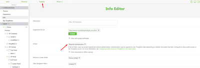

One of the ways to meet your requirement is by publishing each client experience on a unique ThingMark and then share it with the clients.You can create different users in ThingWorx composer for each client and share them with the respective clients. For example, you have 3 client experiences - {A, B, C}
  • Create 3 users such as A, B, C in ThingWorx composer and provide es-publisc-access to these users to access the ThingWorx data as shown below:
    • In ThingWorx, navigate to security -> Users -> New user
    • Enter the Name in the Name field and change the password
    • click Run Time under permissions, add es-public-access user and grant permissions by clicking on green dot as shown below:Screenshot_31.png
  • In Vuforia Studio, publish the experience by choosing the Access type as Requires authenticationScreenshot_32.png
  • Share these users with the respective clients
