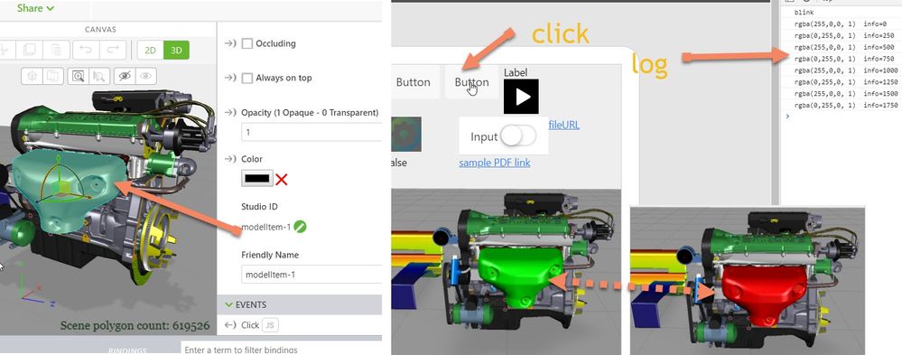

Hi @PhilipB ,
sure it was mention only the principle- the real code should look a littel different. Here is an example which will set a color for 1/3 of Interval of red, for the second 1/3 of green and the for the last 1/3 of the Interval will unset - set it to the original color. Here the sample code:

Here the test:

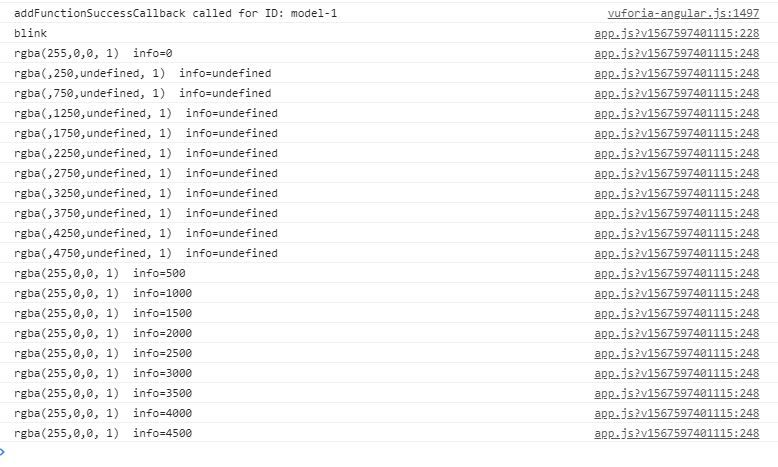

The log when trying out the code above looked like this then:
The experience itself basically did as said in the log, it's the original color first, then it just stays red.

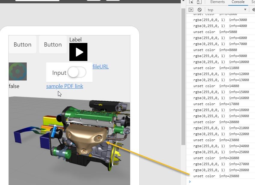

$scope.blink = function (){
  console.log('blink')
   var i;
   var timingInterval = 3000;
   i = 0;
   for (i = 0; i < 10; i++){
      $scope.setColormItem(255,0,0, timingInterval*i)
      $scope.setColormItem(0,255,0,timingInterval*i +timingInterval/3)
      $scope.unsetColormItem(timingInterval*i +timingInterval*2/3)
$scope.setColormItem= function(a,b,c,info)
$timeout(()=>{
  console.log( "rgba("+a+","+b+","+c+", 1)  info="+info)
  $scope.setWidgetProp('modelItem-1', "color", "rgba("+a+","+b+","+c+", 1)")
             },info)
$scope.unsetColormItem= function(info)
$timeout(()=>{
  console.log( "unset color  info="+info)
  $scope.setWidgetProp('modelItem-1', "color", undefined)
             },info)
Here the test:
