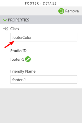

Hi @pathorse,
Could you please try the below css script to change the background color of the footer:
  • Navigate to Styles -> Application and copy the below script
    • .footerColor
      { 	background: #FF0000; }
  • Call the footerColor in the Class Property of the footer as shown belowScreenshot_33.png
    Hope this helps!
