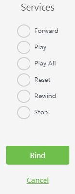

Hello Guys,
Is it possible to freeze/pause/stop, a sequence while an animation is running? Some of my steps are probably 60 seconds or longer with a lot of tool movements and actions -- and it would be great if the step could be paused part-way through by a button. In Creo Illustrate 5.0 its e.g possible.
I know there is a "Stop" Service but it only pause after finishing the sequence.
If someone can help, I would really appreciate 🙂

I'm not sure if there is currently a way to pause an animation that is already playing, but it's possible to "freeze" the camera by using the following services from the 3D Container widget (not the model):
  • Freeze Camera
  • Resume Camera
Check this article in Vuforia Help Center for a step-by-step guide:
http://support.ptc.com/help/vuforia/studio/en/#page/Studio_Help_Center%2FIntermediateHandsfreeAnimation.html

Hey @jyuliya,
thank you for your response 🙂
It is not quiet what I wanted, but good to know. But as you already said, I think its simple not possible (yet).
Thanks again
