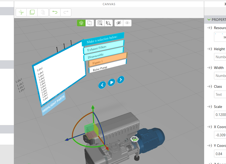

I just updated to the latest Vuforia Studio, and found that I could select and move multiple 3D Images and/or 3D Labels. The glitch is that these movements are not saved, and do not show up in the preview.
The only way to move multiple things (3D Images or 3D labels) is to move each one individually. It would be great if a new version could be released soon to fix this glitch, because selecting and moving multiple things can save time and accuracy, especially if you are trying to arrange rectangular widgets in a list or grid-layout with the HoloLens.
Has anyone else noticed this?

hi @Wes_Tomer
Multi-select is not a supported feature at this time. Our Product team is aware of this request and it has been added to our ideas.

That's good to know. For some reason Vuforia Studio does allow you to select and move multiple items -- it just doesn't save this change.
