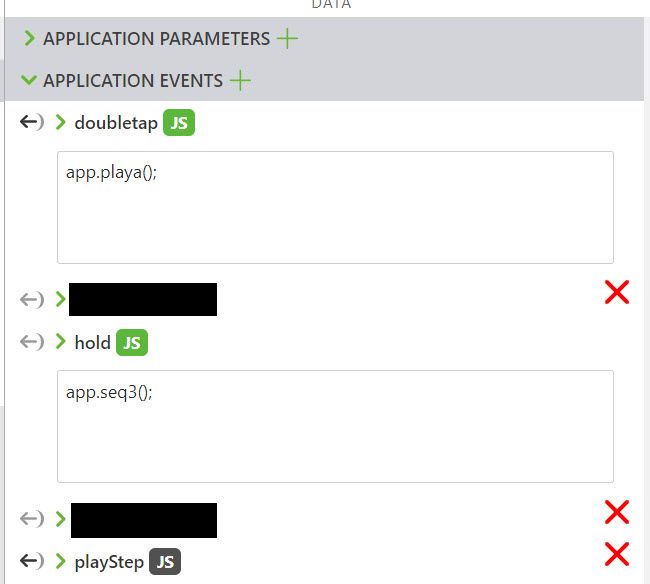

I'm trying to use hand gesture for Hololens 2, but seems noone of the gestures work. Am I missing something?  
Thanks in advance

Hi @GC_10564838 ,
checked on one old HL projects I found where a gesture was used  (currently I use mostly 3d Buttons and userpick)
So there was  definition   in Home.js like this;
$scope.app.playa = function() {
  	$timeout(function () {
     $scope.$root.$broadcast('app.mdl.TestThing.svc.setMystep');
       }, 500);
$scope.app.seq3 = function() {
  $scope.view.wdg['model-1']['sequence'] = 'app/resources/Uploaded/l-Creo 3D - Test.pvi';
     $scope.app.params['sequence'] = 'app/resources/Uploaded/l-Creo 3D - Test.pvi';
    $rootScope.$broadcast('app.mdl.TestThing.svc.SetInfo');
   }, 500);
Here the code but only the function name definition is relevant as example
But I tested and it was working on the device . In the UI :
Please, let me know if similar definition will work for you.

Hi @RolandRaytchev ,
i tested your example but the only gesture recognized is the HOLD.
I also tested on Hololens the "Studio Sample - Hololens Experience" with the quadcopter and still can't recognize my gesture.
So, or i have very bad gesture or probably there is any issues somewhere.
Anyway, very thanks.
