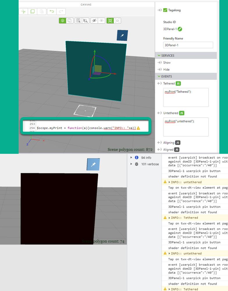

Is there a way to disable and hide the Tagalong buttons of the 3D panels? I've found that people are pressing it without knowing what it does, and they are messing up the layout of the experience.

Hi @AlexK ,
so I think you can use possibly one of the events on this widget. I see that tethered and untethered will fire when we click the symbol which will change the tagalong property :
so possibly you can use some function in the tethered event which will set the tagalong property of the 3DPanel to false e.g.:
 $scope.app.myTetheredEvtCallback=function(){
console.warn("INFO:: Tethered Event called")
$scope.setWidgetProp("3DPanel-1","tagalong",false);
so you can write in the JS box of the tethered event call
app.myTetheredEvtCallback();

Thank you Mr. Raytchev, this works. Maybe I will cover the button with a toggle to hide the panel so there are no "broken" buttons in the experience, that don't do anything.
