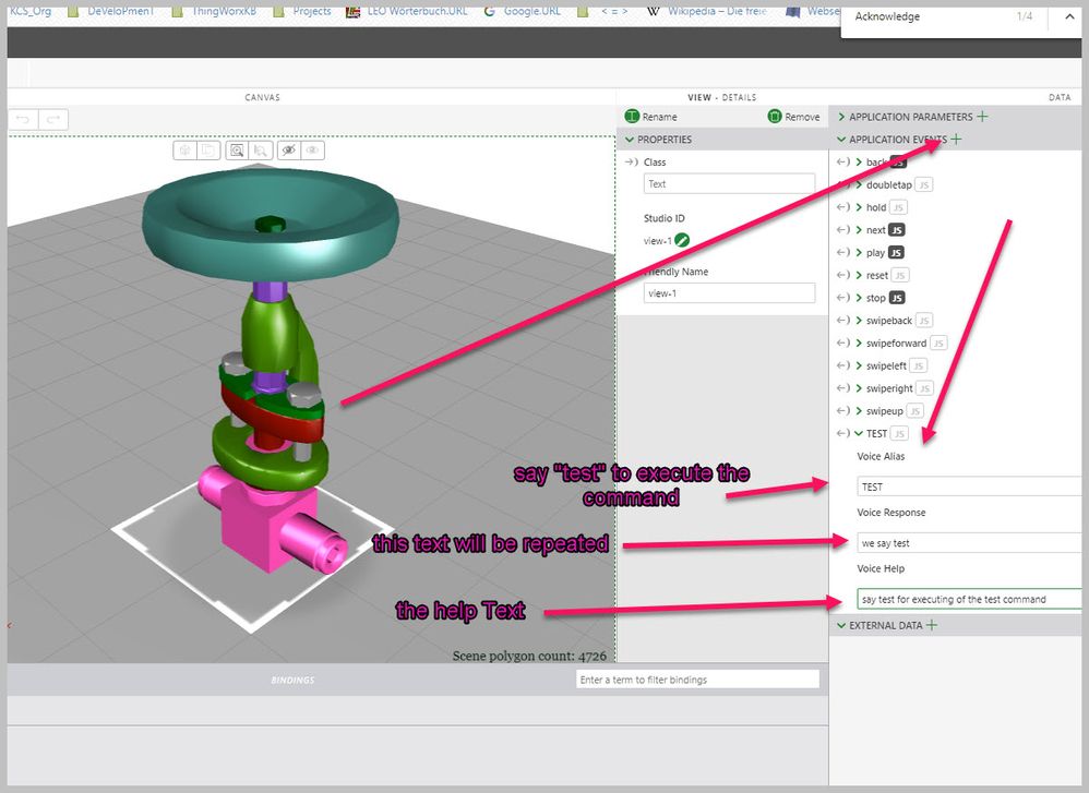

I want to configure audio voice while playing sequencing of cad model in experience so that it will help to user in understanding of sequencing. Any suggestion or help will be appreciated.
5 REPLIES 5
For which    device is it?
Do you mean commands or only speech info?
So for the HoloLense the following function :
$scope.speak = function(spokenText){
var msg = new SpeechSynthesisUtterance(spokenText);
window.speechSynthesis.speak(msg);
will "speak" the spokenText argument string.
On the HoloLens the voice command could be defined easier on the UI.
For android or IOS devices there should be also functionality for example playing some audio files and voice recognition but I did not checked this functionality yet.

Thanks Roland, but i am looking it for mobile devices not for hololens. There is widget in studio for audio voice  but i want to configure this audio voice with sequencing steps. For example when i click on play sequncing button, the sequencing steps (created in illustrate) should also generate audio voice like "in this step,unscrew the the bolt". Rather than showing this kind of message on text label i want to deleiver it in audio voice..
I have no idea ( i did not checked how this should work - there could be a way to do this but need investigations) how to interpret the text to a speech.
One idea what I have is to record with audio recorder the adio files for the different step messages . Then upload the files and use some constuct like this below:
$scope.play_step1_audio = function(){
$scope.setWidgetProp('audio-1', 'audiosrc', "Uploaded/play_step2.mp3"); //to load the step 3 to the adio widget angular.element(document.getElementById('audio-1')).scope().play(); }
And then you can use this on the same way as described in the post/Tech Tip but instead of setting a label you can call the play_stepXX_audio() function:
