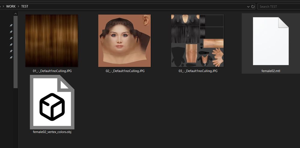

In Design Vuforia Studio I want to associate my Texture image on my Model.
I know how to import a 3D Model in .obj but I don't understand when I link my .mtl file  and my image texture ?
Please see the attached image.
Thank you for the feedback.

For OBJ files with textures to work reliably, all files should be combined into a ZIP archive before uploading to Vuforia Studio. Add the OBJ, MTL, and and texture graphics into a single zip file, and use the Upload Resource operation to load it into Vuforia Studio.
If that doesn't solve the problem, it may be something about the OBJ or MTL file that isn't right. Can you load the OBJ into other software (e.g. Blender) and see it with the texture applied correctly?

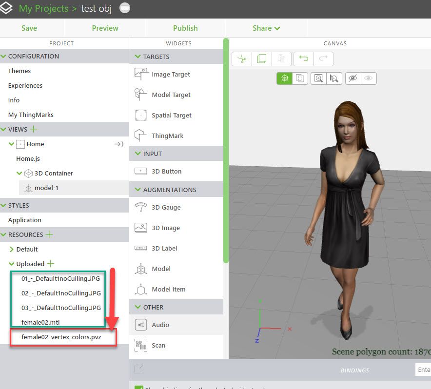

So to check the issue I took the  a sample obj file with mtl and texture from the Tree sample resources -three.js-master- the female-2 (I attached the data)
As I mention in first post- the native cad format /when it is supported by our import tool/ will be converted to the PTC format pvz/. This convert process  will be done by the optimizer tool pvaroptimizer.exe which is called with -r option and  rcp or pvr file/ this contains a settings/. So, for users this make 2 options:
1.) to call the tool form cmd shell and to prepare every thing in the configuration - this is very advance option but allowed the most flexibility.
2.) we can use also the UI - this used the default setting for each known format
But here is one point important -  convert / optimizing process is called only one time when we upload the data to the project. So means we need to import all parts which belongs to the model at once>
Here in the example:
Then we need to click the + symbol in the project Upload folder and select all file which should be converted to pvz. I think better not to select the optimize button.
we can see that it will create in the Upload folder of the project a new pvz file. Then we need to select it and when I tested it -  it was containing  also the texture and will display the example with texture:

I tested the 3D model of the woman, it works.

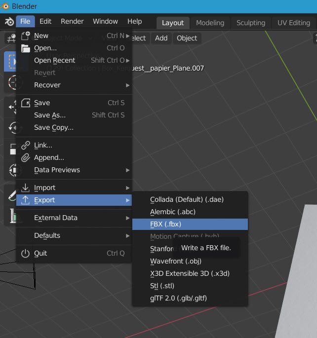

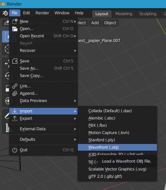

So , as next I took the open source tool blender. I did work many years with Creo Parametric but  I never used Blender before, but installation was simple.
Then I created a new model without geometry and imported  your  obj format:
Then I exported the model to fbx format: e.g. test.fbx
Then  imported the test.fbx file into Vuforia  Studio and converted it to text.pvz. Now in  Studio when I set in the model widget the resource to test.pvz - it was working fine and   the model was displayed with texture .

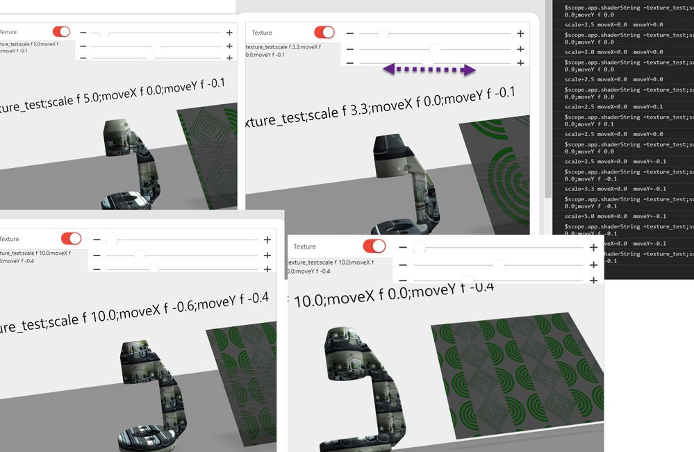

So this is the most used way to use textures in Vuforia Studio.  Also UV setting are something what should be set in the CAD tool - e.g. in Creo Parametric:
3.) In case that we have a texture file  and want to assigned it to a model or modelItem  using some U V parameters in Vuforia Studio  this will make it more difficult. It is possible but you need to define an GLSL shader in the tmlText widget and assigned to the shader property. The glsl shader will used also the file refer in the texture property and could display it projected on the UV model geometry:
e.g. in Javascript;
$scope.app.shaderString="texture_test;scale f 2;moveX f 0;moveY f 0";
$rootScope.$on('modelLoaded', function() {
$scope.view.wdg['modelItem-1']['texture'] = "app/resources/Uploaded/cvc.jpg?name=Texture0&edge=repeat";
$scope.setWidgetProp('modelItem-1', 'shader', $scope.app.shaderString);
$scope.view.wdg['3DImage-1']['src'] = "app/resources/Uploaded/pinger_half.png?name=Texture0&edge=mirror";
$scope.setWidgetProp('3DImage-1', 'shader',$scope.app.shaderString);
Here the pictures are created in project wher I used the following tmlText defintion. Please, pay attention that it is not a solution , but more only an example which display the general usage. If you need more to optimize the display you need to do some improvements - ,please, refer to some addtional links:

So in this example I used the following test shader code:
<script name="texture_test" type="x-shader/x-fragment">
precision mediump float;
uniform sampler2D Texture0;
uniform float scale;
uniform float moveX;
uniform float moveY;
  // determine varying parameters
  varying vec3 N;
  varying vec4 vertexCoord;
  // determine shader input parameters
  uniform vec4 surfaceColor;
  const vec3 lightPos = vec3(1.0, 2.2, 0.5);
  const vec4 ambientColor = vec4(0.3, 0.3, 0.3, 1.0);
  void main() {
    // calc the dot product and clamp based on light position
    // 0 -> 1 rather than -1 -> 1
    // ensure everything is normalized
    vec3 lightDir = -(normalize(lightPos));
    vec3 NN  = normalize(N);
    // calculate the dot product of the light to the vertex normal
    float dProd = max(0.0, dot(NN, -lightDir));
      // calculate the color based on light-source and shadows on model
	  vec2 TexCoord = vec2( vertexCoord )*scale;
          TexCoord.x=TexCoord.x+moveX;
          TexCoord.y=TexCoord.y+moveY;
	  vec4 color  = texture2D(Texture0, TexCoord) ;
      gl_FragColor = (ambientColor + vec4(dProd)) *color ;// surfaceColor;
</script>
<script name="texture_test" type="x-shader/x-vertex">
  attribute vec3 vertexPosition;
  attribute vec3 vertexNormal;
  varying vec3 N;
  uniform mat4 modelMatrix;
  uniform mat4 modelViewProjectionMatrix;
  void main() {
    vec4 vp     = vec4(vertexPosition, 1.0);
    gl_Position = modelViewProjectionMatrix * vp;
    vertexCoord = modelMatrix*vp;
    // the surface normal vector

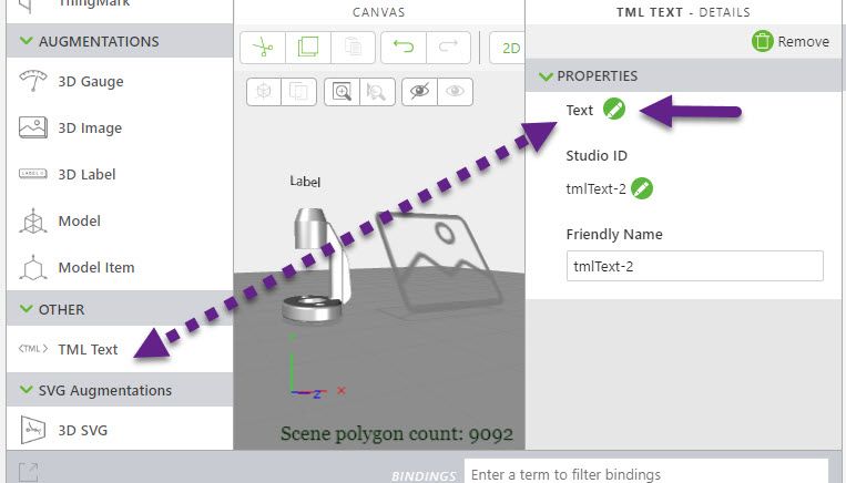

    N = vec3(normalize(modelMatrix* vec4(vertexNormal,0.0)));
</script>
The glsl code should be added in the text area of the tmlText widget:

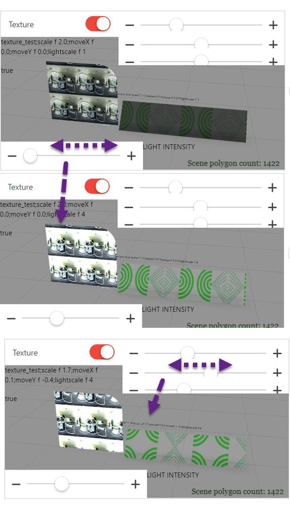

Here to this post I want to provide an sample project which demonstrate how to use the textures with shaders in Studio. Please, pay attention this is only an example which demonstrate the general principle. So far I now this way , works only on mobile devices. I did not get it work with the shader on the HoloLens.
I tested the project in preview on Android and on IOS. On Android and in preview mode it work fine. On IOS it works fine for the ModelItem but not for the 3dImage- but I think there we need to downscale the value of the light intensity:
  gl_FragColor = (ambientColor*lightscale + vec4(dProd)) *color ;// s
project was attached, please, let me know if you have some questions! Thanks!
